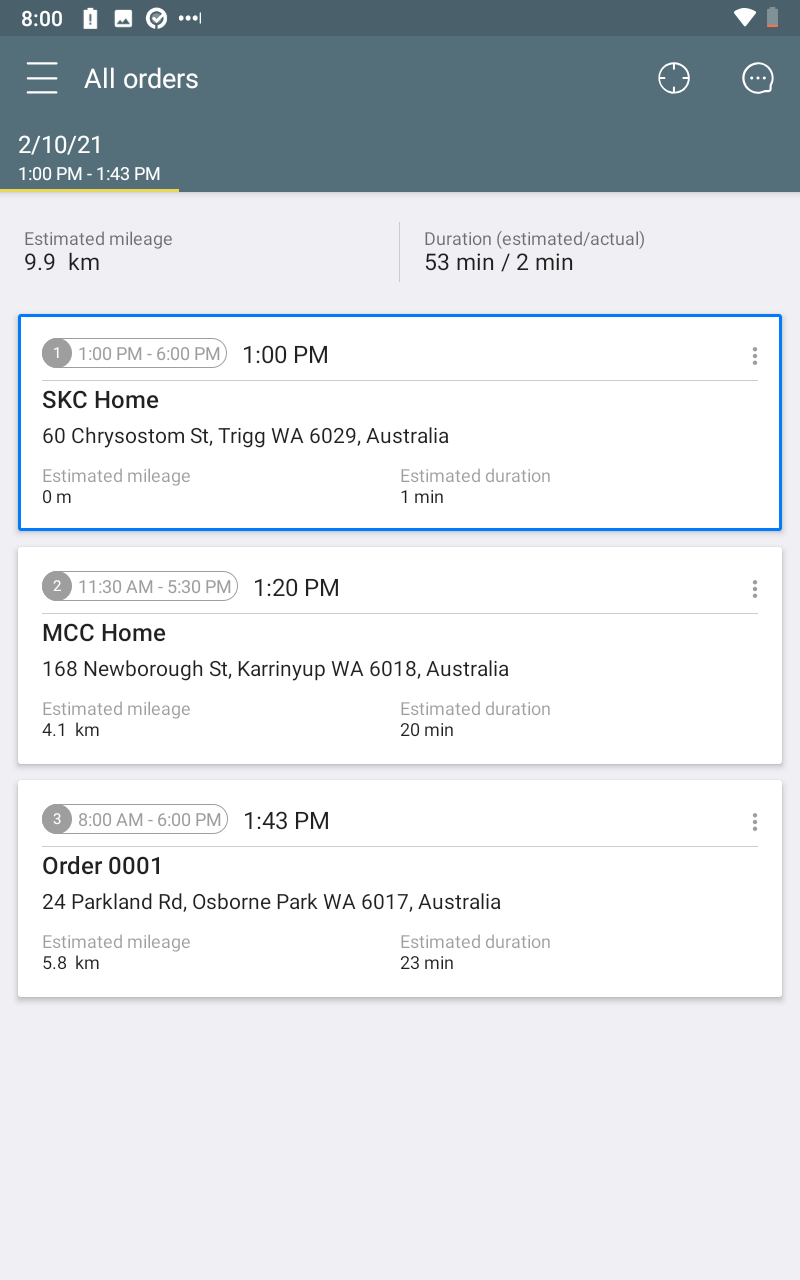

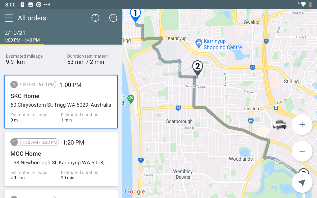

It would help our clients if the date format populated to the Android Tablet from the app or Wialon settings. At the moment, it is defaulting to m/d/yy when our Australian format is d/m/yy.
See attached screenshot.

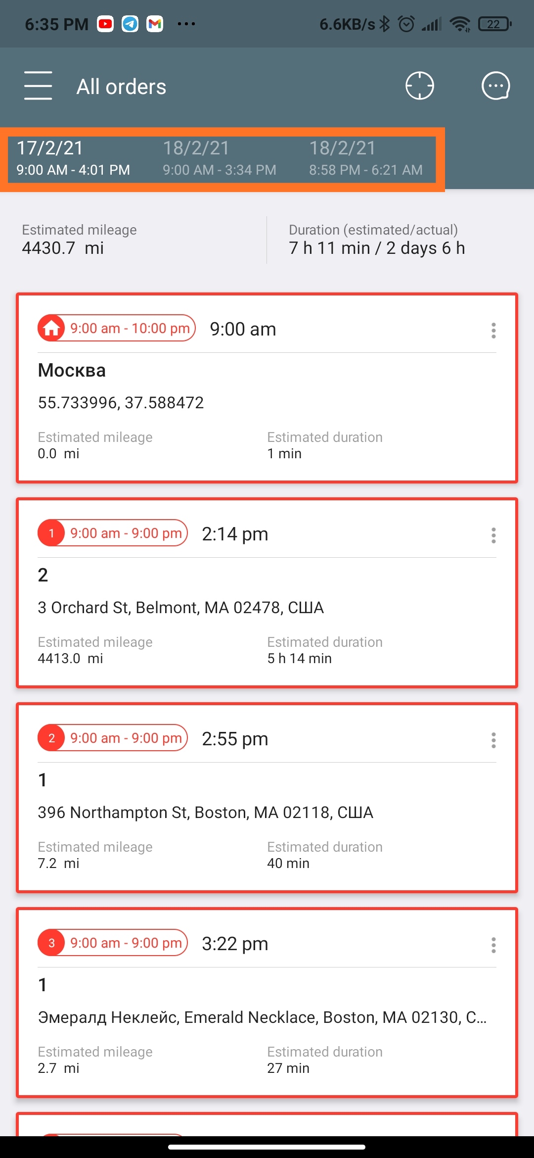

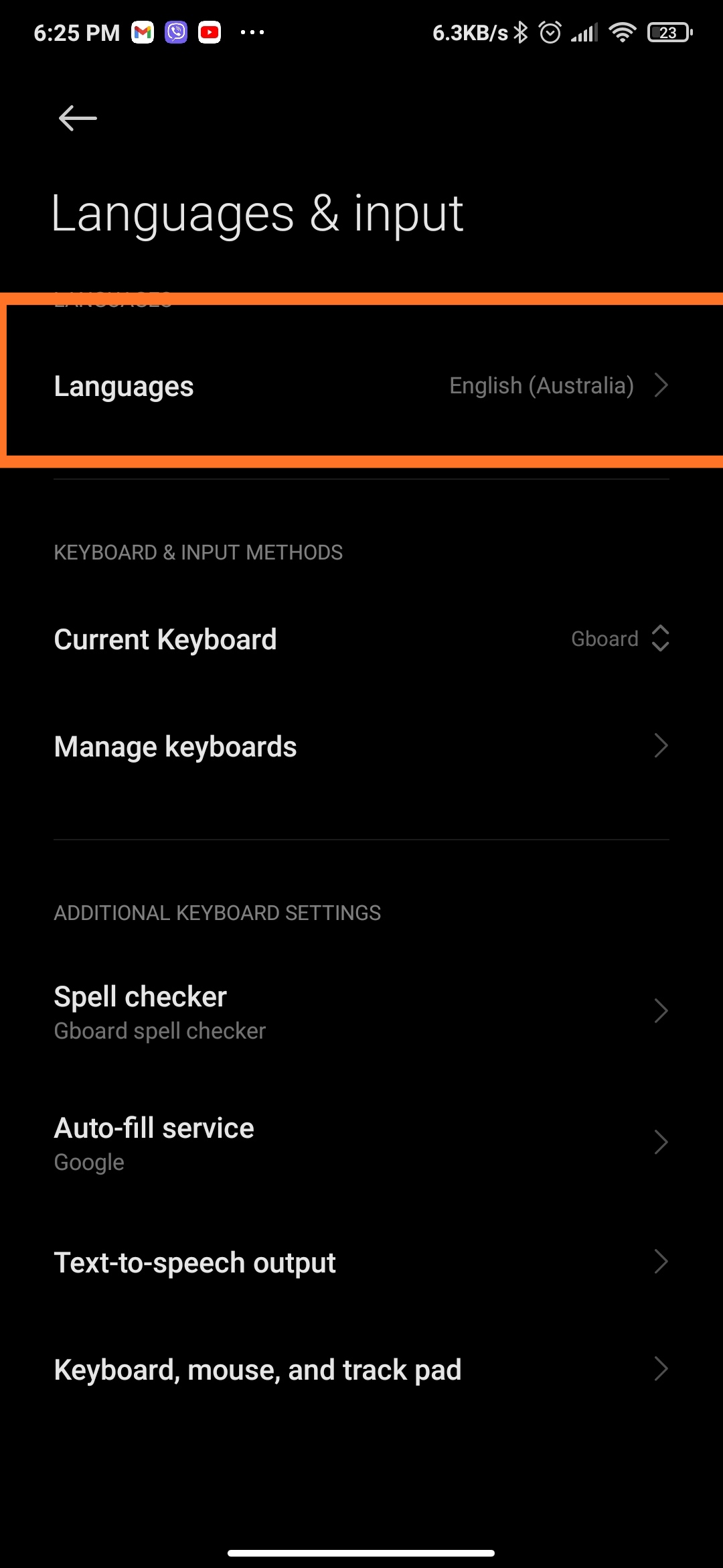

In Logistics Mobile, the date is displayed in the same format as in the Android system. If you select English (Australia) language in the system, the date format will be dd/mm/yy. (attached screenshots)
To display the date in a custom format, the current functionality needs to be improved.
At the moment we have no plans to improve the date format

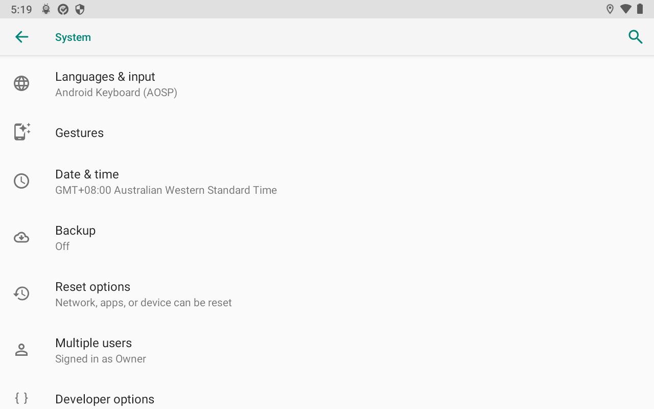

It's strange that Android relate date format to a language rather than the device date/time settings (see screenshots).
We have now fixed with your assistance.
