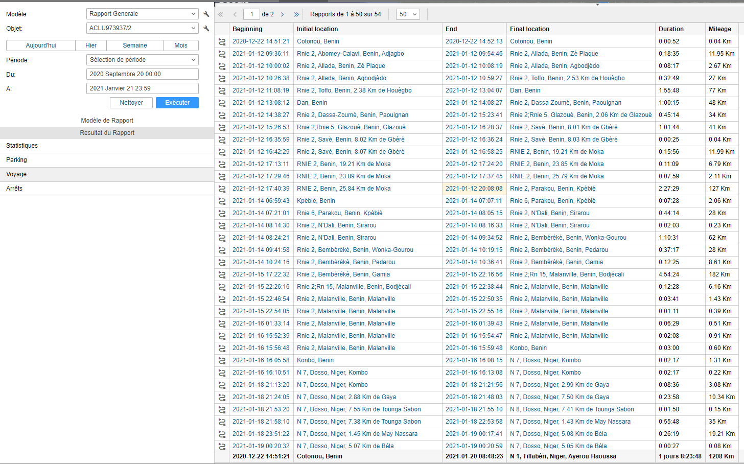

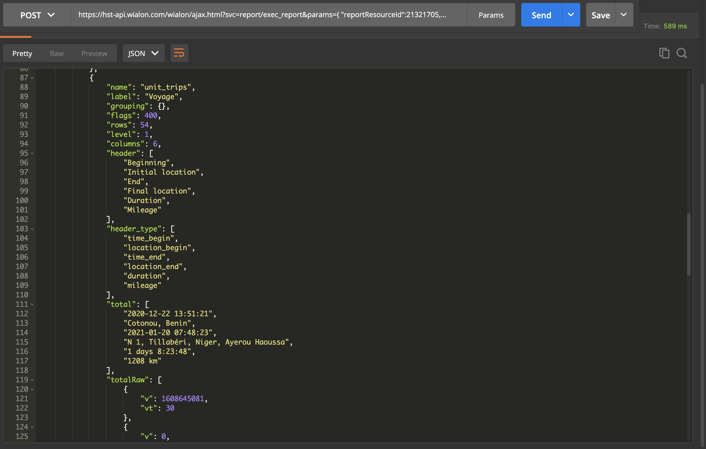

we have a problem.in ours case for eg, we can execute report and get response. But, in the response, we did'nt get the unit trips detail, we just get the sumary wich contain the start and the end of the trips. Note that the report template that we are using is an trips report template that whe had create on platform.
Tached screen explain more
1- report excec result form api
2- report exec result from platform
. Can you advice please ?

hi dyana. thanks for your response. We tried what you advise but we always gets wrongs params.
According to our case, when we get the tables rows blelows, do you confirm this values of unit_trips :   "tableInd:" 1, "level":1 and the "from":0 ,"to":53 ?
Also does it possible to dm you for more explication? my email is megb@sliafrika.com

tried request
https://hst-api.wialon.com/wialon/ajax.html?svc=report/select_result_rows&params: {"tableIndex":1,"config":{"type":"range","data":{"from":0,"to":53,"level":1}}}&sid=312ce86cc0ad70bedd774e0573f883d6
Execute report and export pdf file
Re: Execute report and export pdf file
Hello!
In your example above the following table data :
first table Parkings ("unit_stays") ,  "tableIndex":0  as 1st element in array, named Parking, 5 columns ("header" array), 1 level grouping, rows = 55
second table Trips ("unit_trips"), "tableIndex":1, named "Voyage",  6 columns, rows = 54, level 1
3rd table Stops ( "unit_stops"), "tableIndex":2, named "Arrêts", 4 columns, level = 1, rows =2
So to get Trips data, you request is correct
