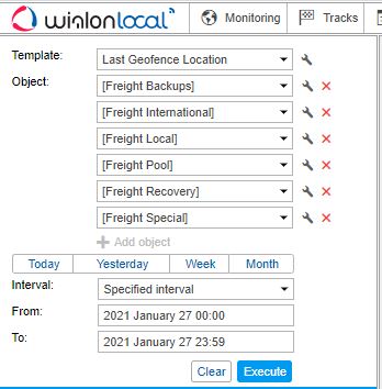

Regarding the reports, I haven't gotten there yet as I am still trying to come to grips with how to get Apps Script to work with the API.
However, I have already created a report which we are running using the Advanced Reporting module which we purchased. Only thing we need to do is add all the required Item Groups as objects and the report works as we require. I will attach a copy of the report for your reference.
