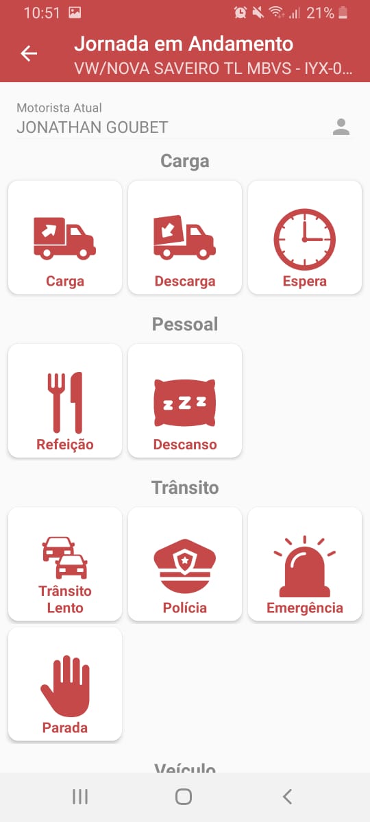

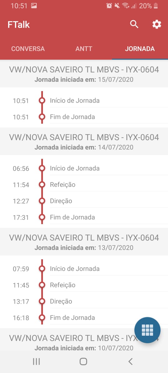

Load/Unload/Oversight Time is called "wait time" here, and its paid differently.
Why Geofences? I believe that using geofences is the best way to automatizate without using any sensors. E.g.: if the vehicle is in this place, is because the driver is having a lunch. The manager create the geofences, group them by function: meal or "wait time", and the platform knows what to consider.
Today we already have this feature in the other platform we use, but the calculation is done by an mobile app with macros, I'm sending some screenshots. It actually doesn't work very well because depends on the driver using the app properly, but when used it works very well.
