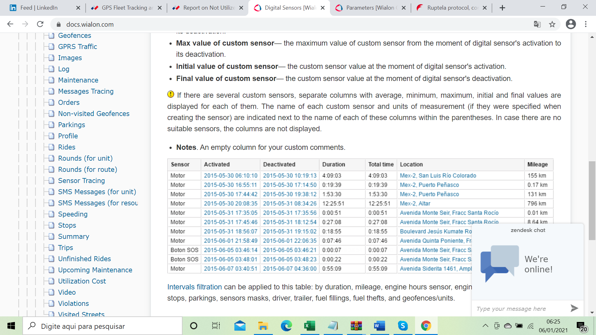

Still it is possible to display in reports the data you requested. Some possible solutions were already mentioned in previous messages. Here is one more:
1. Create ignition sensor with a name "Engine status" (that's just an example).
2. Create a custom digital sensor with a name "Engine is off" and formula: const1-[Engine status]
3. Use table "Digital Sensors" to display duration of active sensor status.
    Don't forget to set a sensors mask "Engine is off" to show only this sensor. To filter minimal duration of 3 days use "Min duration" option.
    Both of mentioned options can be found in intervals filtration in table settings.

The demand it's understandble:The user want a report that selects when the sensor was deactivated to the current date( today for example)     for the current date plus one day.The interval compute the difference of time  when the sensor was on and off   in a day  ,or "compute the   difference   between the final value- initial value".
i'm right?

phillype_loredo пишет:
The interval can be longer than 1 day.
And I want to underline this table shows only the intervals when sensor is on. But if you create a sensor like I proposed, then active sensor "Engine is off" shows when engine is off.

Ok thank you,it's possible understand that logic well:The interval compute a difference of data when the vehicle was "on" and off (a boolean value).When the vehicle it's "off" ,it's the situation that you have said.
