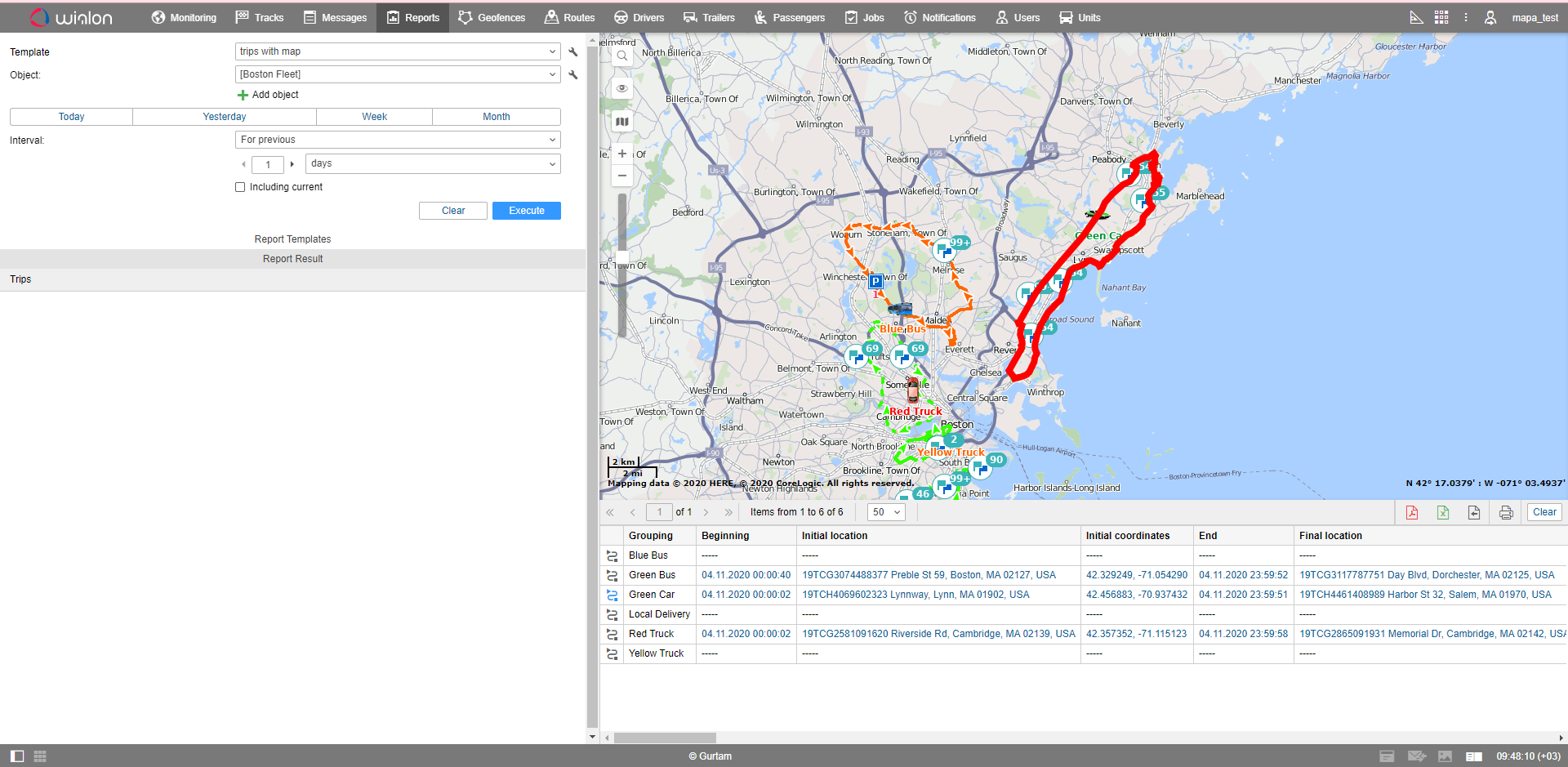

You are right, at the moment there is no option to view the multiple tracks on the "Tracks" tab.
But you could view them on the Reports tab. Please create a Unit group report, add table "Trips" and select the needed columns. Then in the settings of the report add Map output, specify the map's settings. Run the report for the group of units you need - you will see the map with the tracks for each unit. By clicking on the icon in the first column of the table of the report - the unit's track will be centered on the map, all markers of the events are added on the map too.
You could see my video example by following the link https://nimb.ws/nMITr3 or as attached screenshot.
Please let me know if that works for you.
Thank you!
