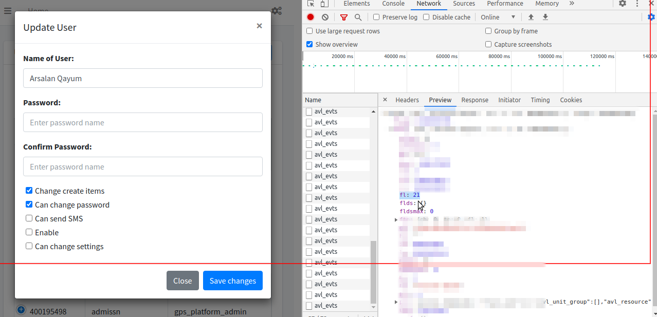

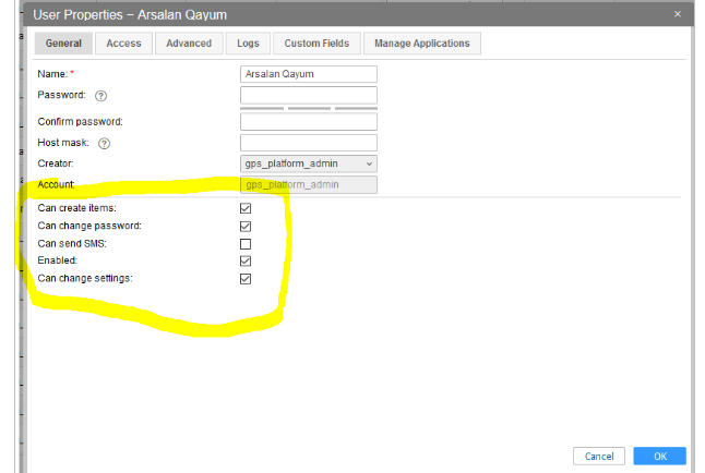

Hi there,
We would like to read/edit user properties. Currently we are able to edit using the update api call(user/update_user_flags) , but we cannot read existing prechecked property items for a specific user. For example in the screenshot blow, we would like to see that user Arsalan Qayum has Can Create Items Enabled, Can Change Password Enabled, Can Send SMS Disabled, User Account Enabled, Can Change Settings Enabled.
We want to show these same prechecked property items in our web application. Thanks

To get information about these flags you need to get user via search item requests with flags = 256 which returns Other properties
Other properties contain parameter "fl" which shows prechecked property items as on screenshot

Hi Chdi,
Your response was helpful, however we still have some lingering confusion.
I am able to get “fl” parameter shown in the screenshot given below. But we still need to reverse that one single digit value and check the checkbox permission properties which are more than just one we need to convert.
I am attaching a screenshot showing the "fl" value.
I am hoping if your team can suggest way to reverse engineer “fl” value. We’re at a stalemate here in trying to code this portion of our application.
