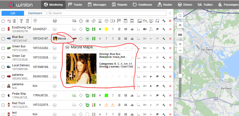

Moreover, there is a separate tab "Drivers" created specially for your purposes. You (or your customers) could create the drivers they have in the "Drivers" tab and link them with the proper units.
The information about linked driver could be added to the monitoring as a separate icon. To do so open "Monitoring panel customizer" and enable the Driver's info, choose the type of info you want to be displayed. See how it could be worked out in my example attached.
Or you could display linked drivers as a detailed information in the monitoring details or in the unit's tooltip. The proper option should be enabled in the Unit's Settings: "Show Additional Information about the Unit" part - "Driver's activity" option should be added to the monitoring's details and\or to the unit's tooltip.
