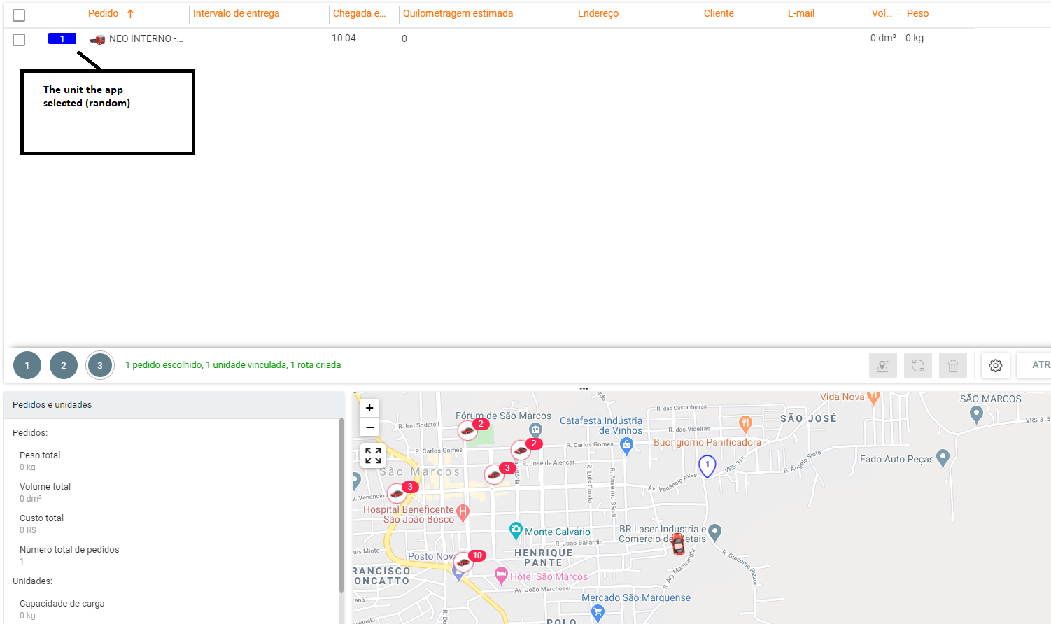

I was looking deeper, I think that this first route from the unit to the first point should also be consider in the estimated time to the first point, please, look the screenshot.

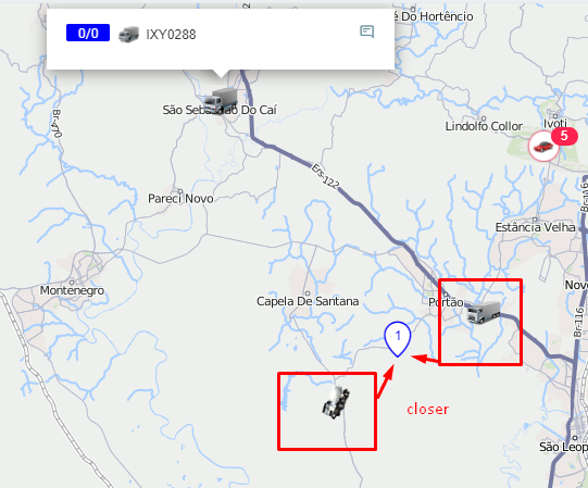

I was doing some tests with the new ability and maybe it need some improvements.
The platform is configurated to take into account only units with engine on? Because I did some tests and it seemed to be working on that way, but other times it was just strange, look the screenshot.
For example clients that work with gas delivery sometimes have the unit finishing a delivery and the vehicle is with engine off, in this cases the right thing to do was to exclude only vehicles parked inside their base, in this case could be selected a geofence for vehicles to be excluded, not to being taken into account when distributing the orders.
Also the estimated time isn't properly yet, the time to reach the first order could be taken into account, what do you think?
