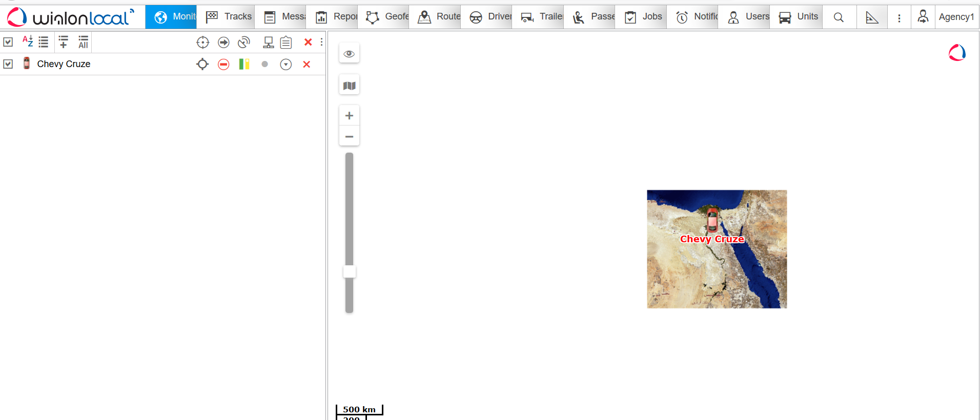

1- The URL, normally the URL shouldn't include the (export) keyword, but in Wialon Local you must attach that keyword for the link to work.
2- Adding map name(s), which is normal since it supports multiple URLs to be added.
From this point on, here comes the rework and trials.
optional inputs are:
Layers ,Base Layers & Zoom Levels.
1- Inputs do not include zoom scales, Which means that the zoom levels you define as an input will not necessarily be the ones you desire, and does not limit any excess zoom out (causing annoying empty spaces around the defined extent of your custom map) or zoom in (causing stretching and pixelization). This will lead to a lot of trials and errors and will not solve it all.
2- These settings are already defined in the Map Service URL and they can be obtained from it without the need to input any zoom levels, scales or layers. Which is an additional amount of rework.
Do any one have a solution for that? or thinks that the process should be simplified by automation?
