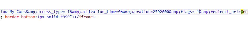

am using the iframe login and set the access type and flags to -1 which should be unlimited access

mfathy, simply check if the account your are using for API has access to Logistics on web version and if it works fine or not. If No, then the problem is related to access of account.
