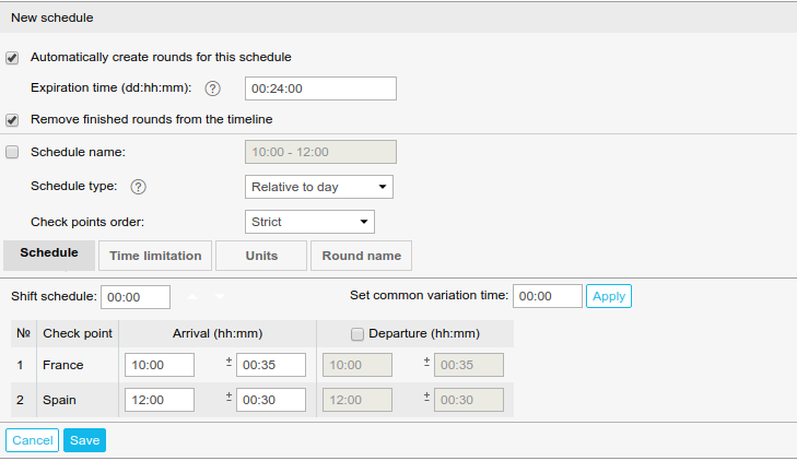

Hello!
The full list of parameters for schedule is here
For example, the response below can create the following schedule as on attached image
https://hst-api.wialon.com/wialon/ajax.html?svc=route/update_schedule&sid=02186bbd5c950e0e55ea09231367e10e¶ms={"n":"10:00-12:00","f":2,"tz":134228528,"u":20685653,"tm":[{"at":36000,"ad":2100,"dt":36000,"dd":2100},{"at":43200,"ad":1800,"dt":43200,"dd":1800}],"sch":{"f1":0,"f2":0,"t1":0,"t2":0,"m":0,"y":0,"w":0},"cfg":{"name":"roundName","units":[20685653],"enabled":1,"roundFlags":2,"autoName":0,"validityPeriod":86400},"itemId":20738013,"id":0,"callMode":"create"}
where
"n":"10:00 - 12:00", /*schedule name */
"f":2, /*schedule type, 2 = relative to day */
"tz":134228528, /*user timezone = UTC+3 */
"u":20685653, /* unit appointed to this round */
//time of passing points, unix
"tm": [
//first point
"at":36000, /*arrival time, means 10:00 */
"ad":2100, /*deviation from arrival time, means 35 min */
"dt":36000, /*departure time */
"dd":2100 */
//second one
"at":43200, /*12:00 */
"ad":1800, /*30 min */
"dt":43200,
"dd":1800
//time limitation, without any
"sch": {
"f1":0,
"f2":0,
"t1":0,
"t2":0,
"m":0,
"y":0,
"w":0
//custom configuration
"cfg": {
"name":"roundName", /*route name */
"units": [
206 /*unitId to create rounds automatically */
"enabled":1, /* 1 means to create rounds automatically */
"roundFlags":2, /* round flags, 2 = strict order + remove finished rounds from the timeline */
"autoName":0,
"validityPeriod":86400 /* validity period to control = 24 hours */
"itemId":207,//route ID
"id":0,
"callMode":"create"
