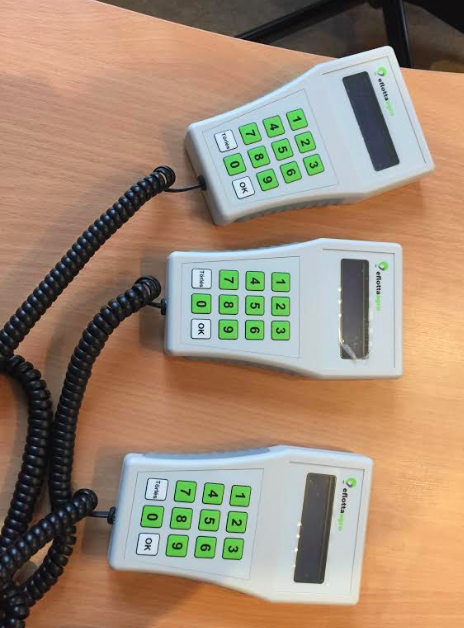

Mainly we are using codepads (see attached picture) for driver/trailer identification (but of course there are other versions such as iButtons, RFID tags).
