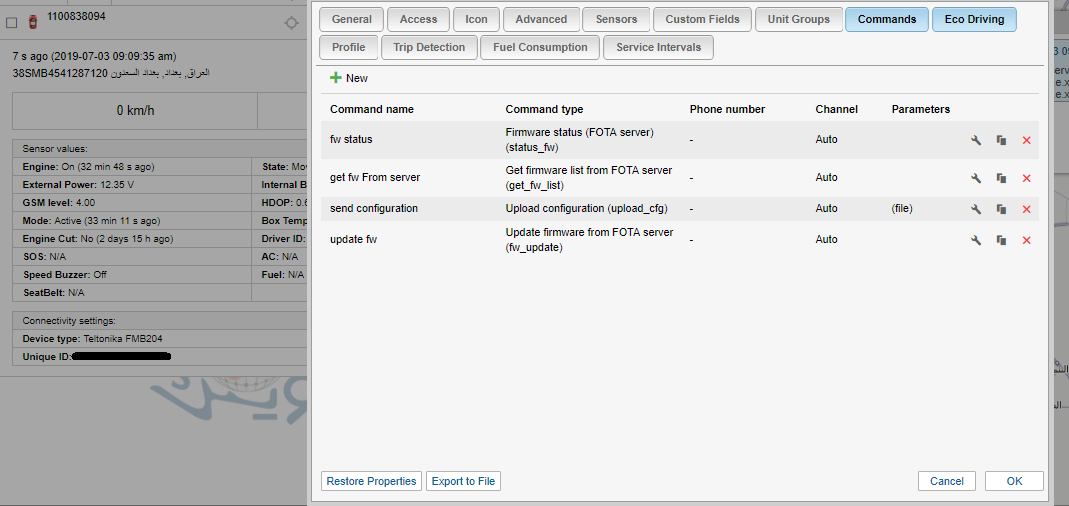

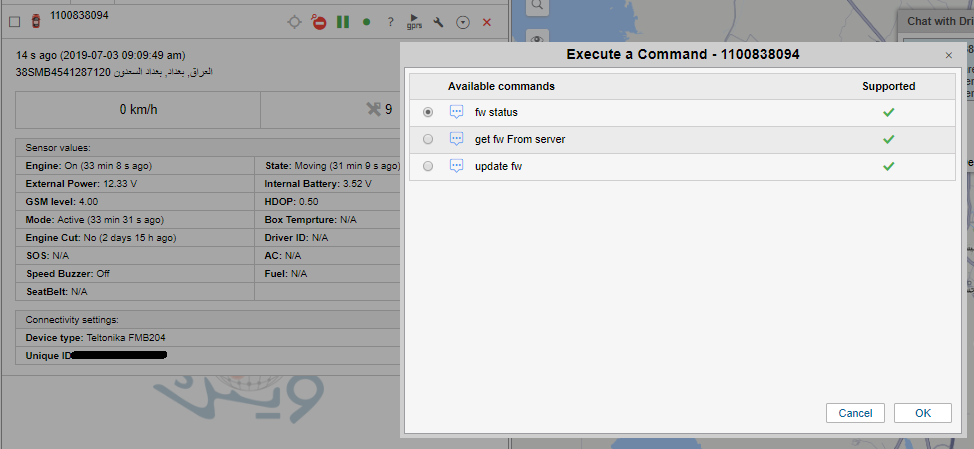

i uploaded the configuration file, but i am unable to execute the command over the unit as you see in images below
the device type is FMB204.
