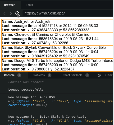

All this topic is not about Wialon, it's about React. The idea is that you have to place Wialon items to React state and update it on Wialon events. And all depends on your React understanding and experience. I created small sample for demonstrating how you can deal with wialon.js from React, hope this helps
Demo: Using Reactjs
Code: https://codesandbox.io/s/react-wialonjs-sample-cwmb7
P.S. please keep in mind that it's just PoC, not production ready app smile
