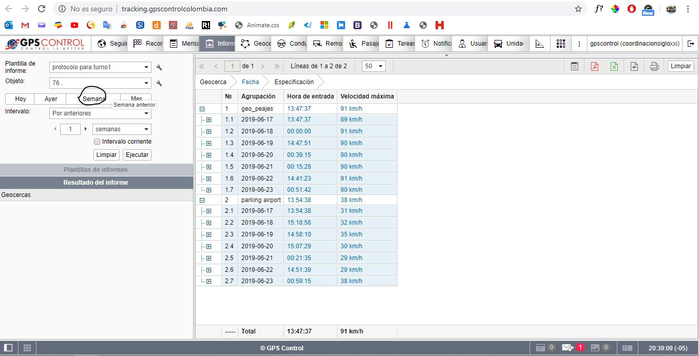

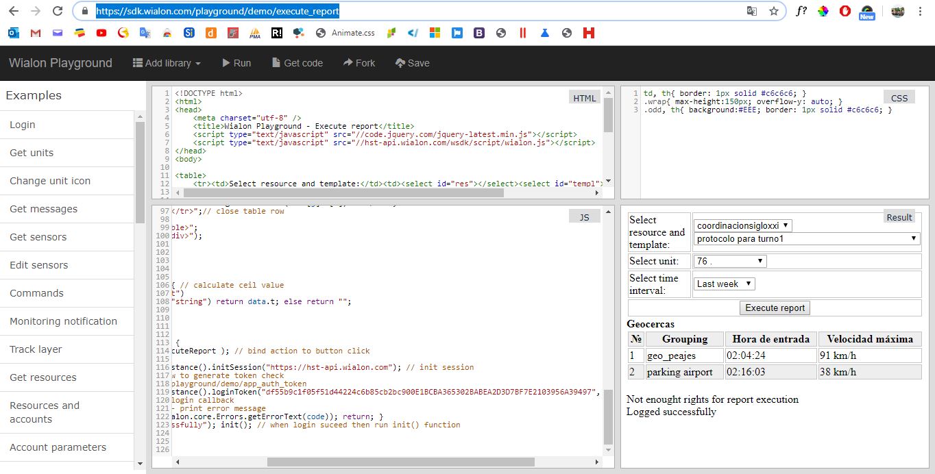

I would like it when executing the same report on the wialon platform and in parallel I execute it in the example codes https://sdk.wialon.com/playground/demo/execute_report
I get a completely distonto result. What is this about? I attach the two images of the result where the comparison is seen.

This is beacuse in the playground example you are getting only the top level rows, you should use an extra method called getRowDetail in order to get those sub rows as described here:
https://sdk.wialon.com/wiki/en/sidebar/ … lt_subrows
