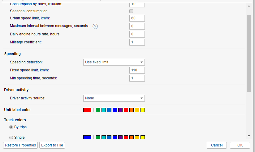

I have created on Unit file for Advanced properties for Speeding but when I importing that file for one of group which is called 'abcd'  after that there is no change of speeding in any unit and I also check one by one I saw same setting is shown as before.problem is that that user have lots of car and its difficult to do setting one by one , after this for light vehicle I have to prepared speeding to 130 and for buses 110. Kindly help to solve this problem.

Speeding settings for import is not in the 'Advanced properties', they are included in 'Report properties'. Please, see description in the docs https://docs.wialon.com/en/hosting/cms/port/unit
I suppose that is the reason. If not, please, send your wlp-file.
