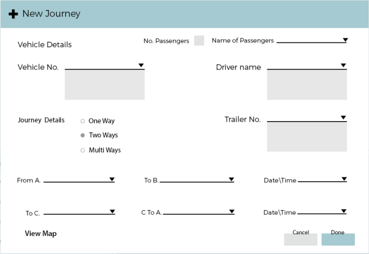

Please take a look in the attached screenshot.
As per our requirement, Admin can create journey, select unit, passenger, driver and trailor.
Journey can be one way, two way or multi-way.
When clicking on Done button what we need to do? Which API we need to call create round OR create route ?

Good afternoon!
It is possible to use the request create_route for route creation. After that you can use the request update_checkpoints to add checkpoints to the route. And also you can use the request update_round to create/update/delete round

Now after creating route using create_route and update_checkpoints, we need to also track that journey so Do we need to create round (update_round)?
In our case as per above attached screenshot, Do we need to create round after create_route and update check_points?
As per above screenshot can you please tell me which update_check points we should use from map, geofence or unit ?
Yes, you are right. You neeed to use round for route tracking. See more about round here https://docs.wialon.com/en/hosting/user/routes/rounds
Yes, you need to create round after route creation because you assign round with route.
It depends on your goal.
