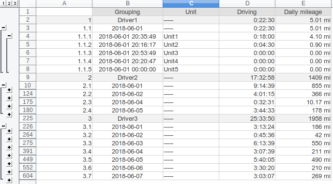

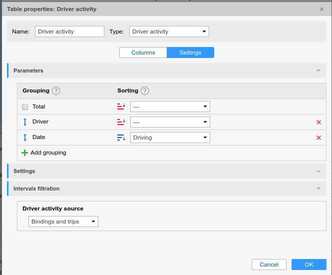

I'd suggest you try table for a group of drivers "Driver activity".
Select some columns and settings: grouping by driver, grouping by date and sorting by "Driving", driver activity source - "Bindings and trips".
Then you'll easily find driver violating hours.
See an example of settings and result in the screenshots.
