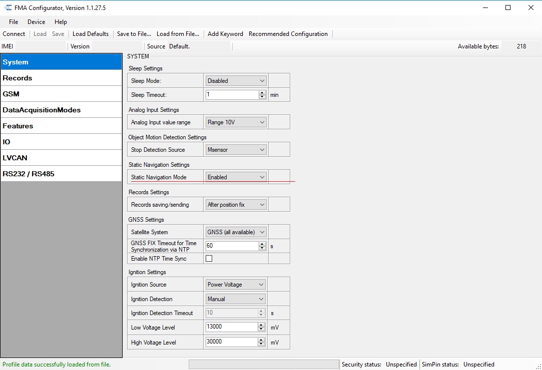

when stop, gps is always moving small speed.
how can i fix it?

Hello!
Try to "enable" "static navigation" at unit configuration

Sorry i can't find  "enable" "static navigation" How to find it? Could you screen shot on me?

Please pay attention to attached picture. Tab "System" at device configurator
