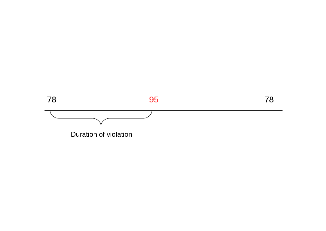

But I have one more question. How to count a duration of such speeding?
We have two variants now:
1. from the previous message to current message with the violation. as we suppose, the car started exceeding the speed before we get the message with the violation
2. don't calculate it. just sign as "--"

The existing method works well because we always have two messages as minimum and can calculate the duration between them.
And if we change this we need to think of the new concept of calculation duration with just one message with a violation.
So we have some variants how to calculate the duration of the violation: one is shown on the screenshot, other variant is not to calculate it (--) and one more variant is to display 0:00:00 duration. What do you think?

the screen shot is better,we record duration from the previous message to the violation message
