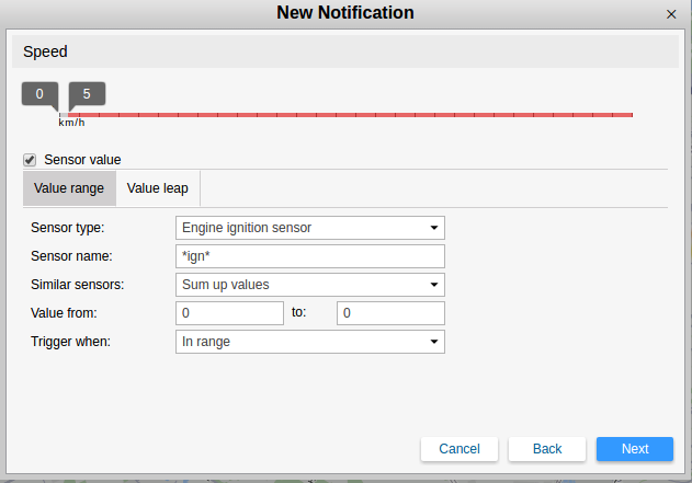

sales.gps.zoom, you can create a notification on speed that corresponds to moving and with 0 Ignition sensor value.
There is another form. In the configurator of the FM1120, in scenarios you can actually configurated it to send a parameter where 0 is no active and 1 is active.
