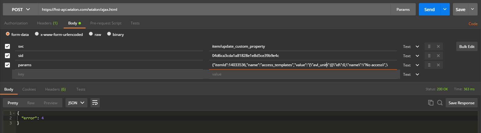

Hi Gurtam Support,
I am using update_custom_property remote API to create access templates for an user but every time when I hit the API I am getting back error code 4 which is Invalid Input.
I wrapped all the parameter values with double quotes properly ( sample req show below ) , can you please let me know how to achieve this ?

Deal,

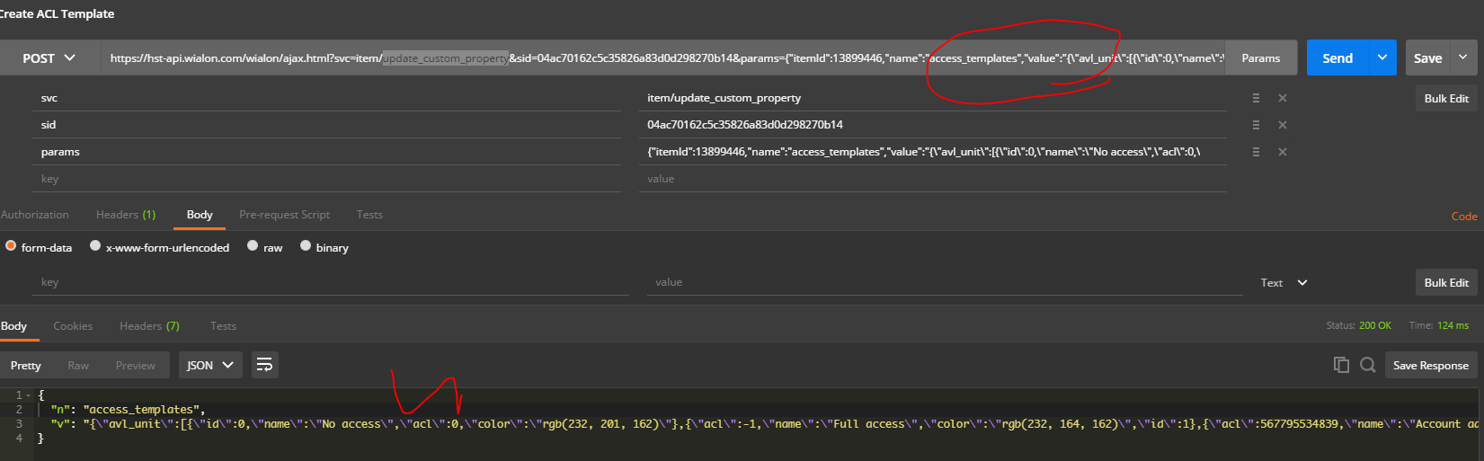

I am using remote API client tool called PostMan to test the wialon API's, and in postman if I use the payload as part of http body I am getting error code 4 and if I send it via http params the same API was successful ( I attached both the options screen shot here ) - But other API's all are working fine with http body and only the update_custom_property API is failing.
Let me know what is the correct way to consume the wialon remote API - Do we need to send the payloads via http parameters or can we pass via body ?

Re: Access Template Create/Update/Delete for an User
karthik, just set option x-www-form-urlencoded.
Head of Wialon Local Department
