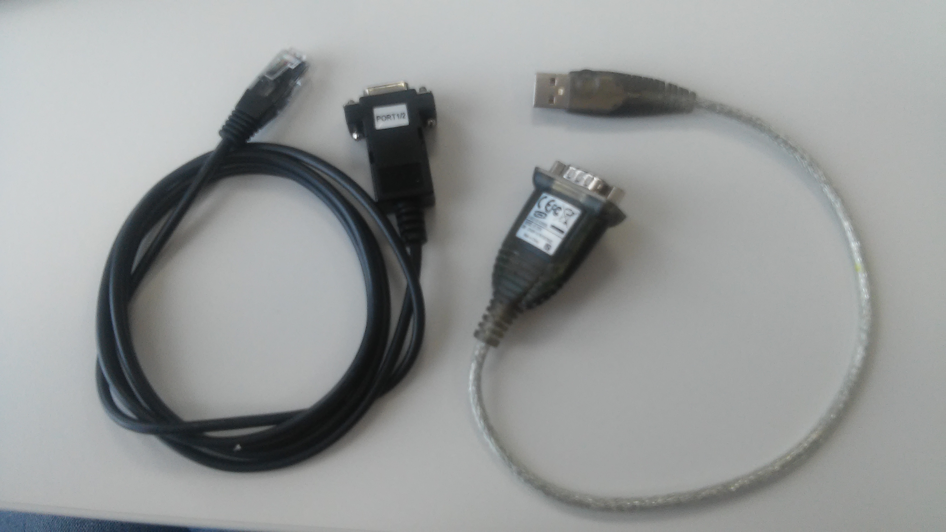

Hello
Cant connect teltonika fm4100 to the PC. İts says
Please Help!
  • Teltonika FM4100
21
Teltonika FM4100
Re: Teltonika FM4100
EminEK Which exactly data cable do you use?
Please see attach
If you have COM port on your device you should use LAN-COM cable.
If you don't have COM port you also should have USB-to-COM adapter  (don't forget to install the driver for this item and check the number of com port)

yavi пишет:
Please see attach
Thanks for answer yavi.
Im using both of them. (USB-to-COM and original Teltonika cable for configuration)
Whats interesting there is no problem to connect another Fm4100 devices to my notebook which also means that drivers are ok.

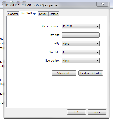

yavi пишет:
Try to check the number of COM port (In Windows device manager, tool which is responsible for USB-to-COM adapter). May be the number of com port is changed?
Here is the settings of port
  • Teltonika FM4100
25
Teltonika FM4100
It seems that smth is wrong with exactly this device...
