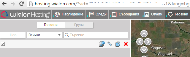

I can`t create geofences. I read menual but my button NEW is inactive.
I tryed to make route and after that to save in geofance but without any success. I using wialon hosting. Could somebody help me?

Bozhidar, Your user Officevip doesn't have access to any of resources. Resources are storing geofences and other propitems.
That's why You can't create and even view geofences.
If You don't know how to resolve this problem ask about that Your dealer or personal manager or our technical support (support@gurtam.com).
