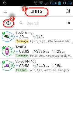

1. Go to "Units" section, click on the "Eye" button (Image 1).

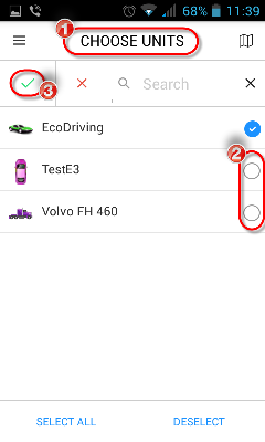

2. In the "Choose units" section, leave the boxes checked only for the required units, click on the "Map" button (Image 2).

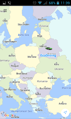

3. On the map, you will only see the selected units (Image 3).

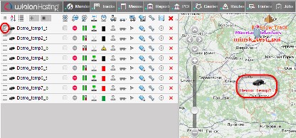

If you want to see the required units in Wialon Hosting in browser, simply leave the necessary boxes checked in the first column of the Monitoring panel (Image 4).

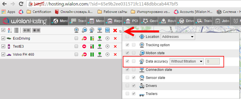

1. In Wialon Hosting (browser), Monitoring panel shows the units that you want to see and add.
For automatic work list update, you can set "Data accuracy" period (e.g. last half an hour) in the Monitoring panel (see image).
You can do it only for the work list or for work list + map.
And in this case the Monitoring work list + map (as well as some other services, such as Notifications) will only show the units that were sending data in the last half an hour.
But the map will still show the unit(s) with the checked boxes, as explained above.
