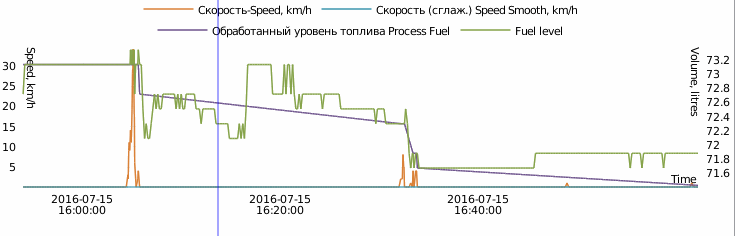

The problem is that we are getting fake thefts and fillings just when the vehical stops for a few seconds( 30seconds or so) in traffic. Most of the fuel thefts and fillings are around 7 to 10 liters and take place within just 30 to 40 sec. This seems to be not possible as when you see the graphs you can see the Vehical engine was on and had just stopped for 30 sec or so. What kind of setting can we apply to avoid this.
The problem is the the sensor by default filters the data for over 120 sec by default.
I am very confused on how to solve this problem .. please can someone help

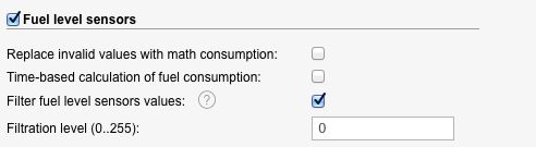

Maybe you can try the option " Filter Fuel level sensor values" on Wialon.

How much it should be set ?

Hello Nadeem,
Apply the filtration level to 250 points and check.
