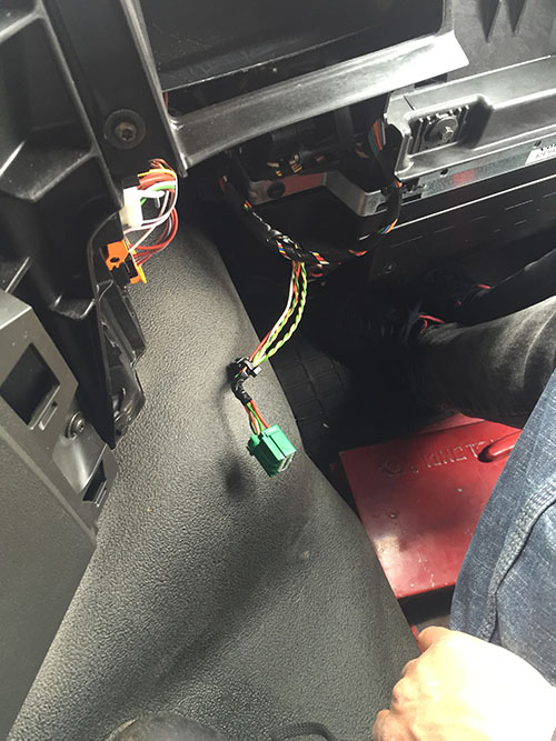

I have tried to install CAN Enabled GPS Tracker on Volvo FM-400 2016 model truck, we connected to CANH (yellow) and CANL (Green) wires and set the GPS to read FMS protocol. I am able to retrieve some information like engine speed, temperature via CAN.
My primary interest is to get Fuel Level , Fuel Consumption rate and axle weight information, but cant fetch any of these details from the CAN BUS. can you please share your experience or advise on what I should do to get the required details via CAN BUS from the specified vehicle.
Attached are the photos of the dash and the CAN wires for your reference.
