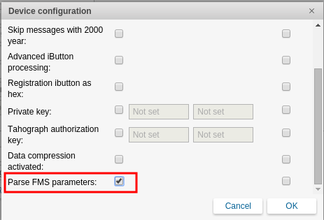

We've added registration of values from FMS as separated parameters.
To activate this opportunity, please enable the option "Parse FMS parameters" in device configuration window:
