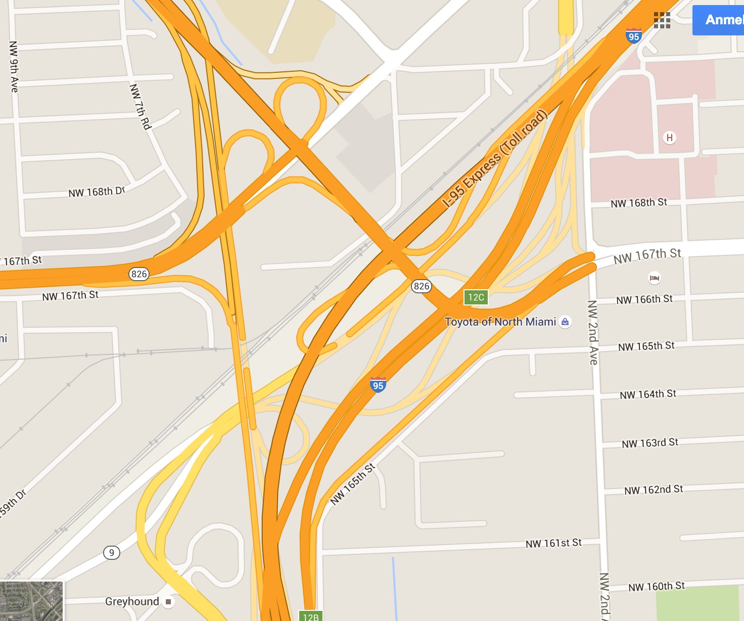

Nasnew,
experience just shows, that "speed limit information" is not acurat. it changes often. and in complex road situations the delay of gps transmission, data analysis in Wialon, Serverload of data analysis etc. makes such a system not practicable. And only imagine, the data is not correct, you can driver faster as your data shows, your truck is trying to overtake another truck and the system devices "ohh, i must limit the speed now"... your customer will love you for this!
Also: Wialon can access only speedlimits from some special sources. As speedlimits are connected to map data, YOU need to provide this map data together with the speedlimits in a format, gurtam can easy import. than you have to be sure, that your data connection is always available, only imagine you blocked the speed to for example 50km/h, but your truck is now on a motorway where it could drive 90km/h but because some gprs problems with your provider the Wialon can not update the speed-limiter.... and so on and so on.
So dynamic speed limiting a car is not implemented in any country i know because of the above reasons.
Wolf.
