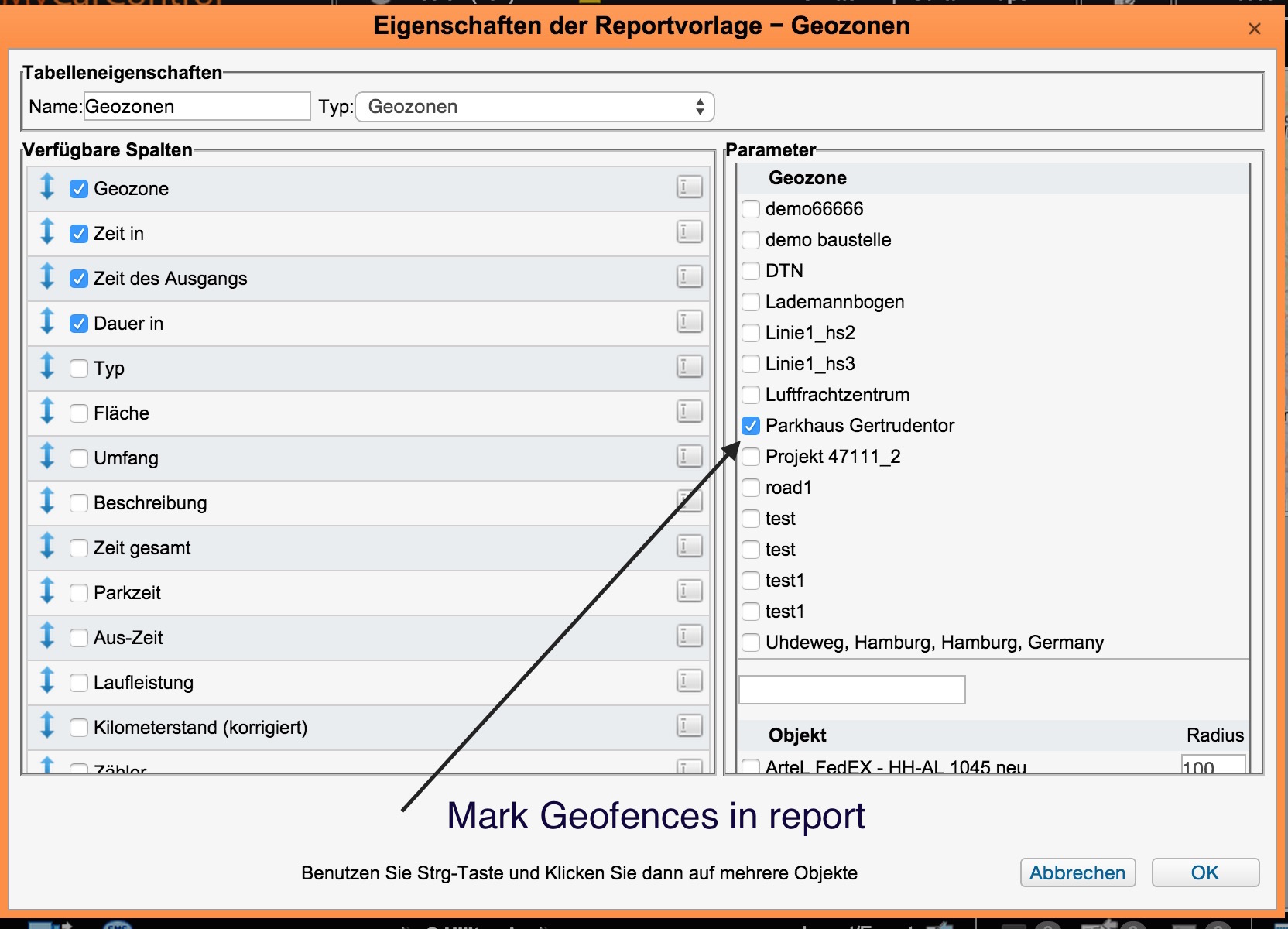

here a sample screen from a geofence report. typicaly NO geofences are market. you need to select them manualy.
Diana also wrote, that the names of geofences must be the same! so if you change name of geofences, you also need to update the report template!
