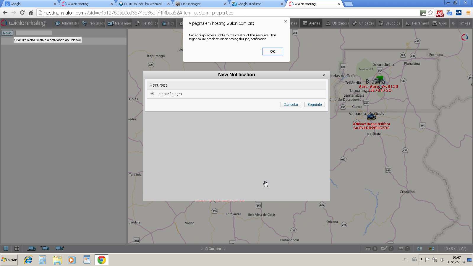

I can not release access for customers to create their own alerts; Previlérgios no error appears to it; already released full access cms.wialon. My clients can create virtual fences, but not the alert for them.

Hello Renato!
It requires access rights to user which is a creator of resource where is notification
More detailed information is provided in e-mail
If you have other questions please write to our support@gurtam.com

Thank You worked as follows:
1 - cms.wialon created in the group and I linked to a user created with full rights, and it worked.
