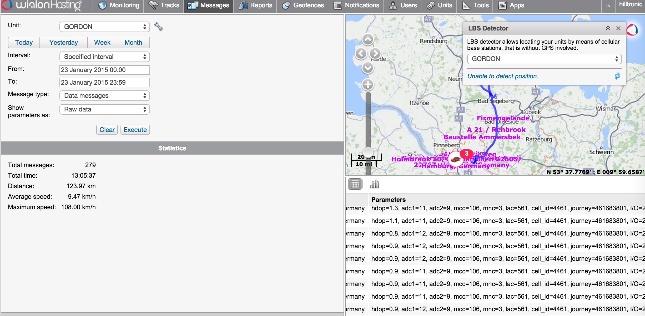

our little server is installed at a windows virtual server and has the opencellid.org cell-list on a mysql database (4 Million cellids with location).
If a new message by UDP is received from server, it scans the message and does a lookup of celltowers in the local database. than it calculates the different distances and tries to do some kind of weighting. than it uses Wialon IPS protocol and sends the calculated "position" to Wialon (together with some infos we receive from device). Additional the little server logs into sdk.wialon and sets a geofence with the calculated radius (so if gps=valid, radius is a few meters, if GSM it uses the TA (timing advance value) of the served cell to create the radius) to the middle of the served cell and you can see it in Wialon.
