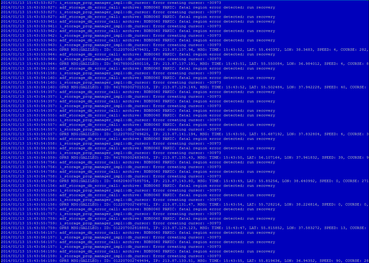

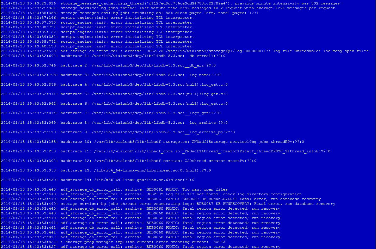

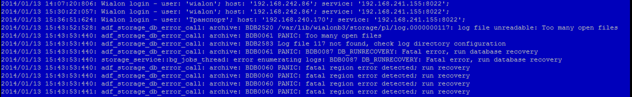

Периодически зависает сервер
2013/08/15 10:21:39:382: 'voyager_2-tcp_packet.tcl'[576]: unknown script error
2013/08/15 10:31:04:109: script error in '/var/lib/wialonb3/plugins/avl_base_setup/diskspace_checker.tcl': couldn't create output pipe for command: too many open files
2013/08/15 10:31:04:109: 'diskchecker'[373] line 1 error: couldn't create output pipe for command: too many open files
2013/08/15 10:31:05:596: script_engine::init: error initializing TCL interpreter.
2013/08/15 10:31:06:593: script_engine::init: error initializing TCL interpreter.
2013/08/15 10:31:20:227: script_engine::init: error initializing TCL interpreter.
2013/08/15 10:31:29:023: script_engine::init: error initializing TCL interpreter.
2013/08/15 10:31:29:621: script_engine::init: error initializing TCL interpreter.
2013/08/15 10:31:30:221: script_engine::init: error initializing TCL interpreter.
2013/08/15 10:31:30:421: script_engine::init: error initializing TCL interpreter.
2013/08/15 10:31:30:621: script_engine::init: error initializing TCL interpreter.
2013/08/15 10:31:30:821: script_engine::init: error initializing TCL interpreter.
2013/08/15 10:31:31:222: script_engine::init: error initializing TCL interpreter.
2013/08/15 10:31:32:624: 'std7-tcp_packet.tcl'[492]: unknown script error
2013/08/15 10:31:32:824: 'std7-tcp_packet.tcl'[492]: unknown script error
2013/08/15 10:31:34:025: script_engine::init: error initializing TCL interpreter.
2013/08/15 10:31:34:425: script_engine::init: error initializing TCL interpreter.
2013/08/15 10:31:37:033: script_engine::init: error initializing TCL interpreter.
2013/08/15 10:31:37:228: script_engine::init: error initializing TCL interpreter.
2013/08/15 10:31:38:228: script_engine::init: error initializing TCL interpreter.
2013/08/15 10:31:39:029: script_engine::init: error initializing TCL interpreter.
2013/08/15 10:31:40:030: script_engine::init: error initializing TCL interpreter.
2013/08/15 10:31:40:430: script_engine::init: error initializing TCL interpreter.
2013/08/15 10:31:41:030: script_engine::init: error initializing TCL interpreter.
2013/08/15 10:31:42:833: adf_storage_db_error_call: archive: BDB2520 /var/lib/wialonb3/storage/pl/log.0000000009: log file unreadable: Too many open files
2013/08/15 10:31:43:281: adf_storage_db_error_call: archive: BDB0061 PANIC: Too many open files
2013/08/15 10:31:43:281: adf_storage_db_error_call: archive: BDB2583 Log file 9 not found, check log directory configuration
2013/08/15 10:31:43:281: adf_storage_db_error_call: archive: BDB0061 PANIC: BDB0087 DB_RUNRECOVERY: Fatal error, run database recovery
2013/08/15 10:31:43:281: storage_service::bg_jobs_thread: error enumerating logs: BDB0087 DB_RUNRECOVERY: Fatal error, run database recovery
2013/08/15 10:31:43:281: adf_storage_db_error_call: archive: BDB0060 PANIC: fatal region error detected; run recovery
2013/08/15 10:31:43:319: adf_storage_db_error_call: archive: BDB0060 PANIC: fatal region error detected; run recovery
2013/08/15 10:31:43:419: adf_storage_db_error_call: archive: BDB0060 PANIC: fatal region error detected; run recovery
2013/08/15 10:31:43:544: adf_storage_db_error_call: archive: BDB0060 PANIC: fatal region error detected; run recovery
2013/08/15 10:31:43:611: adf_storage_db_error_call: archive: BDB0060 PANIC: fatal region error detected; run recovery
2013/08/15 10:31:43:649: adf_storage_db_error_call: archive: BDB0060 PANIC: fatal region error detected; run recovery
2013/08/15 10:31:43:849: adf_storage_db_error_call: archive: BDB0060 PANIC: fatal region error detected; run recovery
2013/08/15 10:31:43:850: adf_storage_db_error_call: archive: BDB0060 PANIC: fatal region error detected; run recovery
2013/08/15 10:31:43:851: adf_storage_db_error_call: archive: BDB0060 PANIC: fatal region error detected; run recovery
2013/08/15 10:31:44:050: adf_storage_db_error_call: archive: BDB0060 PANIC: fatal region error detected; run recovery
2013/08/15 10:31:44:051: adf_storage_db_error_call: archive: BDB0060 PANIC: fatal region error detected; run recovery

Вот куски логов service и trace на момент начала генерации ошибки, ошибка пропадает на какое-то время после ребута сервера.

Ksingh
Ошибка
adf_storage_db_error_call: archive: PANIC: Too many open files
говорит сама за себя.
Варианты  решения  данной проблемы описаны  в постах выше.
Что из предложенного сделано у  вас?
