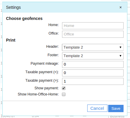

Hello everyone
Today we installed small update - now you can choose one of printing template in app settings. Play with header/footer param and find template best fit to your customers.
Also we added payment calculation - you can specify mileage cost in settings.
