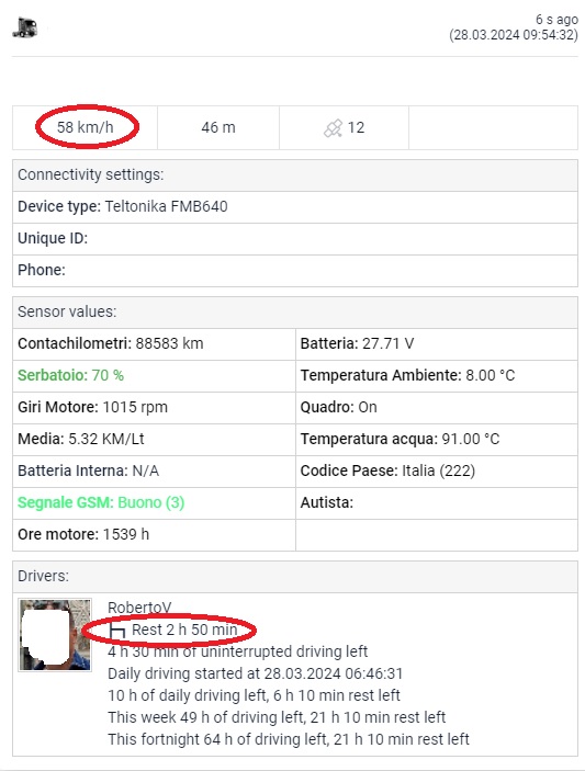

Good morning, I have a problem with the driver's activity.
The vehicle detail window displays the driver paused even when the vehicle is travelling. The messages rightly indicate type 3 activity (driving) and in the advanced settings there is the setting for reading the tachograph data.
Where am I doing wrong?

jommi check the availability of all the required parameters and also their values. Open the Messages tab, switch to the Raw data format, in the filter field put the following string:
tco_driver1_id=*,tco_activity_type1,tco_activity_tm1,tco_distance=*
Hit Enter, and check the messages from your example, if all 4 parameters are well received. If any is missing, the activity is not considered as valid and skipped. The previous valid activity is then continued.

There is no tco_activity_tm1

That is the reason why the activity is not registered. The tracker should send all parameters.

Thank you so much.
Now all work fine!
