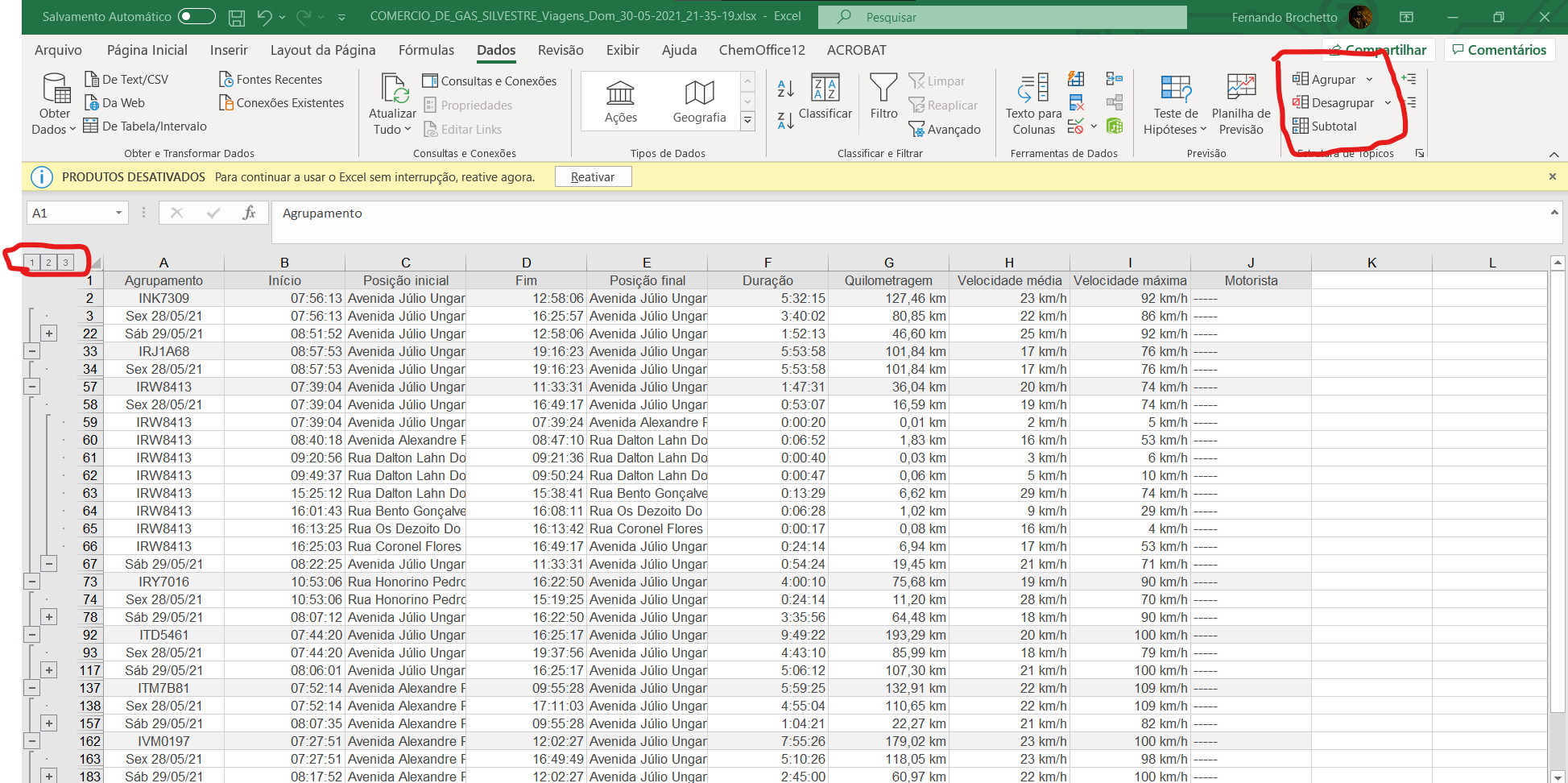

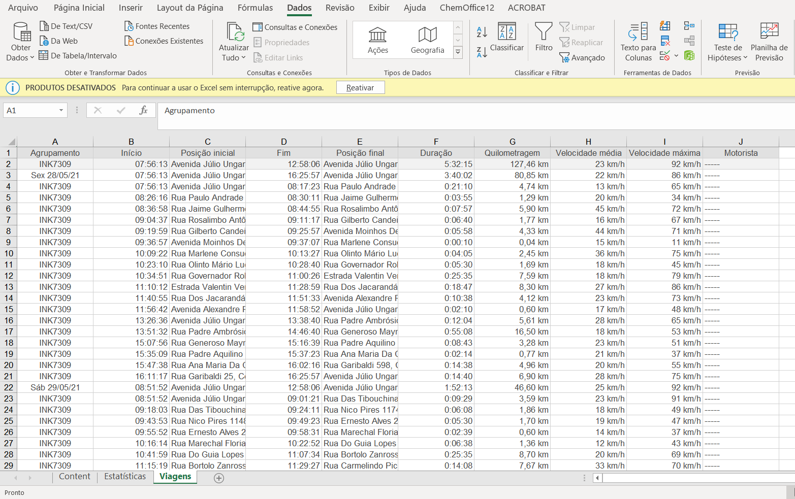

hello mars, I think I didn't explained properly.
An option for when exporting, so that the report was not ''compressed, grouped'', look the screenshots.

Hi, Fernando! Thank you for the screenshots.
Do you mean having an option when exporting reports to automatically display rows as uncompressed in a file?
I really wonder whether it worth such complexity of a specially dedicated checkbox in the export settings when you can make rows uncompressed by simply clicking on icons '2', '3', etc. in a file itself (highlighted in your screenshot). Very easy and quick.
