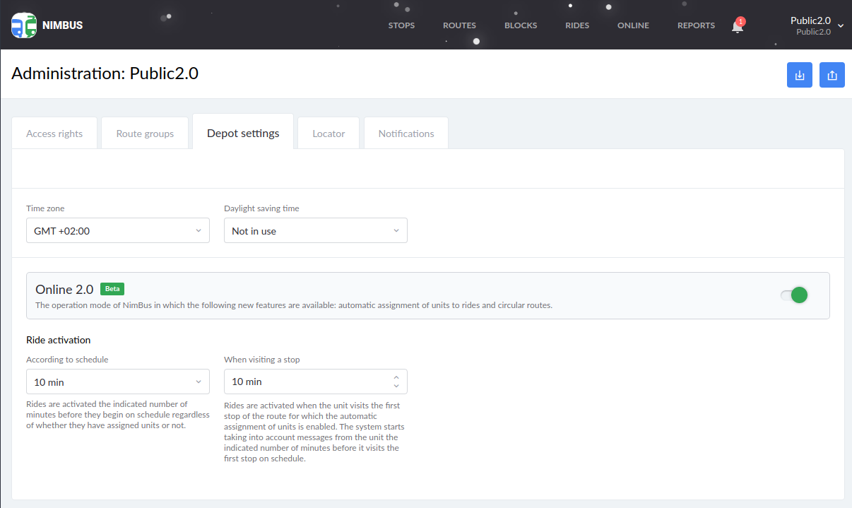

Now you can use a new message processing strategy in NimBus. This allowed us to add a new type of rides activation: by visiting a stop (geofence). While these changes are subtle, they open up many opportunities for further development of the system.
Is Online 2.0 enabled by default?
No. If you have a project using NimBus, at the moment it continues to work with the old version of the tracking module. You can activate the new mode on the Administration page in the depot settings (see instructions below).
