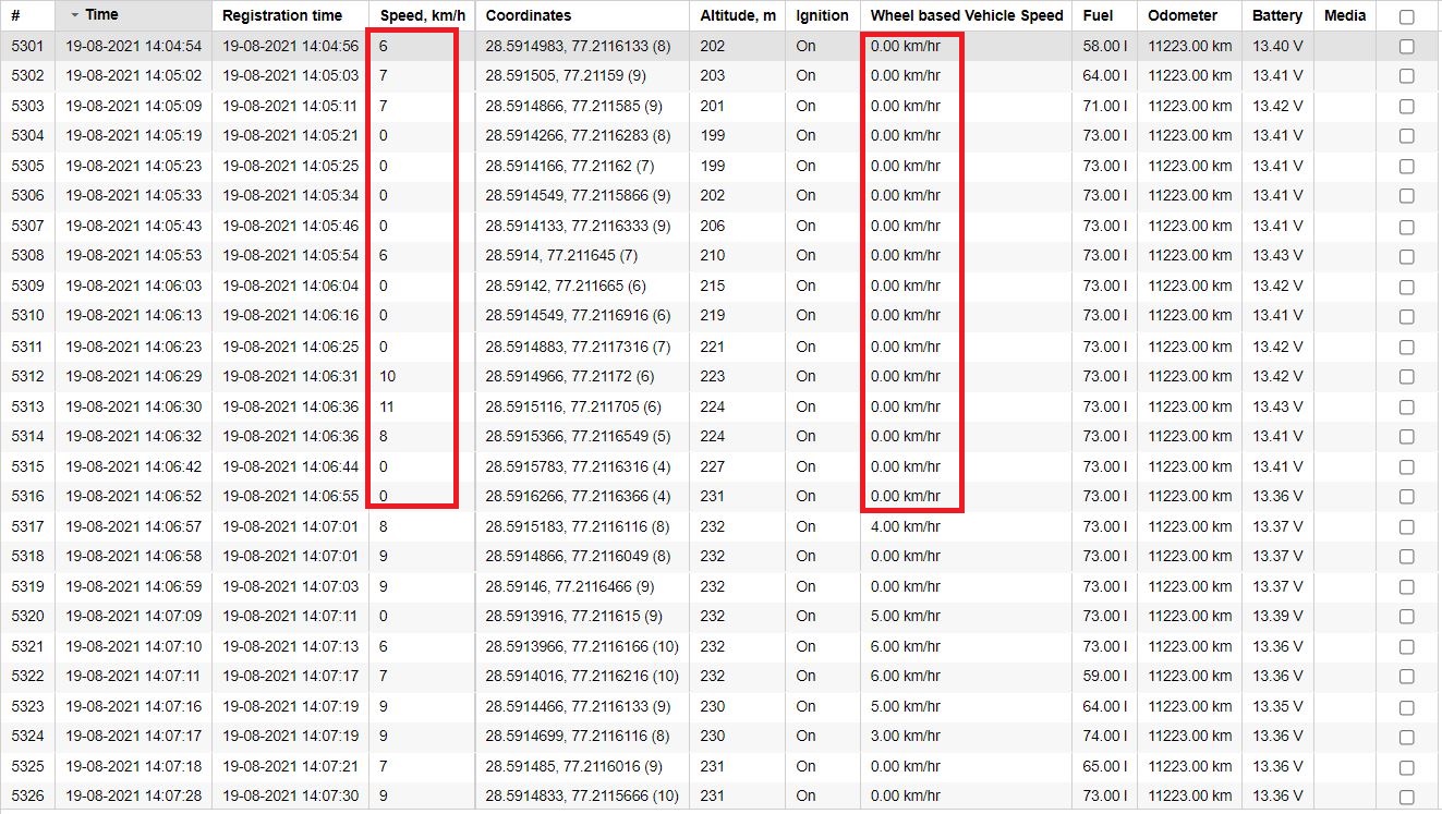

Hi Mana,
I was reading this post today. I have a scenario here with regards to the incorrect gps speed value and I think the solution that is being discussed here might solve my problem as well.
My customer is using an OBD device which is capable to provide OEM data (fuel level, real odometer value and real wheel based speed) directly from the vehicle. Yesterday I had a situation where there was a fuel filling done in the vehicle but the same did not get recorded in the reports under Fuel fillings table. The reason was -  In the fuel level sensor settings, we have the option selected as "Detect fuel filling only while stopped". It appears that during the time of filling, due to the tracker and gps issue, the unit was continuously giving some false speed based on data received from gps. But in actuality, the vehicle was parked at the time of filling. This is evident from the value of the custom sensor "Wheel based vehicle speed" which is correctly shown as "0" during the time of filling. Please see attached screenshots.
Here to resolve the problem without removing the option "Detect fuel filling only while stopped", I have to increase the "Min moving speed" on the Trip detector tab which is not a very good thing to do OR
The problem might also be resolved if we have an option to make the system to consider the real speed based on OBD sensor value instead of gps speed. Kindly let me know your thoughts.

Hello vkjain,
Exactly, if we could for example validate the speed sensor with a motion sensor, your case could be solved as well, even without CAN bus speed data.

Hello vkjain,
thanks for your case and attached screenshots - it helps me to better understand the tasks that we have to solve in the development process.
I think your example will be completely covered by the solution I suggested above. Also since we want to create a new type of sensor, then validation will be available for it, as well as for other sensors, if it is necessary.
This year we will definitely not have time to solve the task, because development is quite labor-intensive, and the proposed list of tasks has already been determined by the end of the year, but we will definitely be engaged in its implementation since it is a high priority for us and is needed by a large number of our partners.
