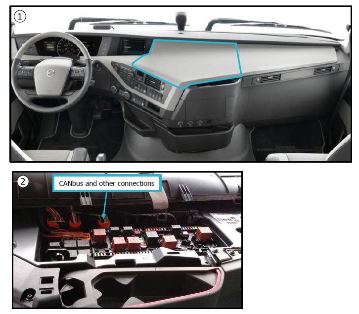

hello, someone here already installed a tracker on a volvo fh 2019 and made a connection with his CANBUS? 1939 and 1708? I am having difficulty finding the module and the wires to be connected to the vehicle.
Good day Thiago, Don't know if they were 2019 but talking about EURO 6.
Recently we equiped Volvo FH at the CanBUS. It's located in the dashboard, close to the fuse box.
The yellow wire is the CAN HIGH and the green wire is the CAN LOW
Check picture attached.
