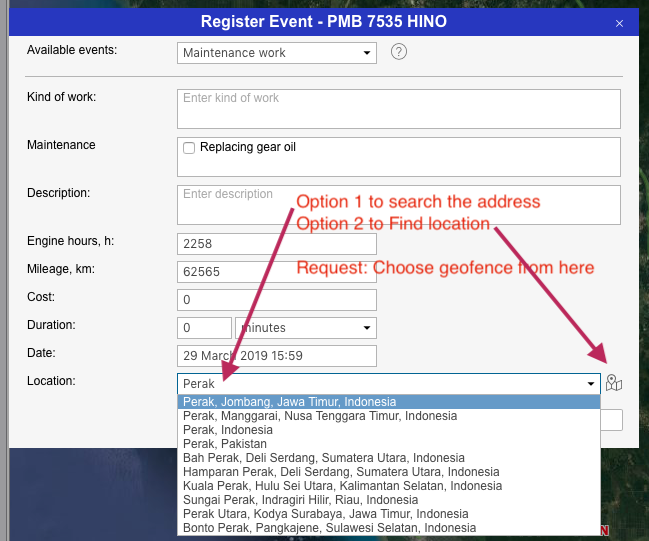

In Register Events, under available events "Register Maintenance" I was trying to search for the location in our country and unfortunately couldn't find and Support assured to update the same in a week or two.
Now my second concern is, its only possible to click on the map to get the address.
My request is why can't we select from the geofence already created which will look much better in reports.

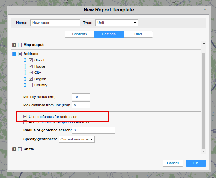

Dear orosgroup,
If your purpose is to see geofences in reports, then use the option I marked on the attached screenshot in a report.
Also, I cannot but recommend you our special application for maintenance Fleetrun. You can find there more tricks for maintenance control.

Hi,
I am not looking at getting geofence in reports as this is a secondary requirement. What I am trying to tell is when you go to Register events, now there are two options to add the location, one is to type the name and find the nearest matching name and second is to choose the location by clicking on the map. For example if the maintenance workshop is market as a geofence, its it possible to recall the geofence as the location in "Register Events"
