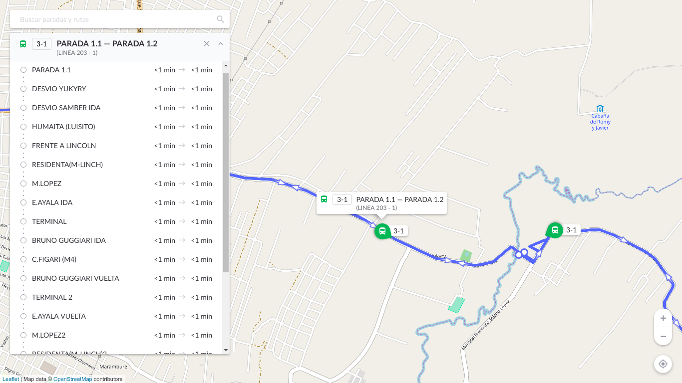

Can you please indicate how to get the route associated with a unit through the JS SDK?
I need to replicate the information that you see in the screenshot in a mobile application

1. You can find all documentation about Nimbus API (REST requests) here
2. In order to your screenshot if you need to get Stops you can execute request 'Get all the stops of the depot'
3. For Nimbus app there is not JS SDK, only REST API
4. What do you mean about hybrid app? Regarding token in your app you can use (create) token with limited access, please look more information here
