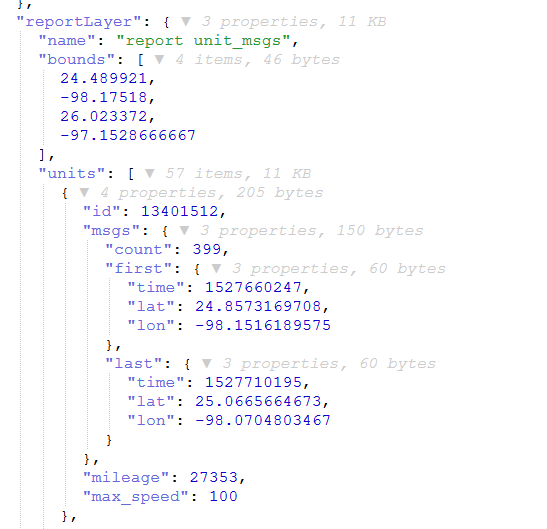

there is a way to get the alias of the units in the response I get when I run a report
when I run the report I get an id and the mileage of the unit
How can I get the alias of the unit in the same answer?
  • problem when executing report (remote API)
Re: problem when executing report (remote API)
You already know the id of the Unit so
Create a core/batch with
svc : core/search_item
and
svc: report/exec_report
