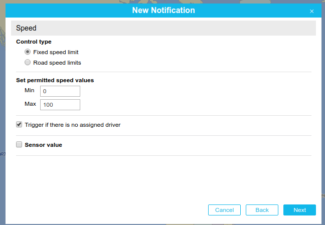

Hello,
We would need a notification what could help to find out which driver(s) are not using the iButton (or other type of driver ID solution) when the car/unit is moving (or the ignition is on for x minutes).
So it would trigger when a digital parameter is "ON"  and the driver ID is missing.
Unfortunately we couldn't find a solution for this.

Re: "Missing driver when the car is moving" notification
The option is available in the notifications type "Speed".
Please, try it. And your feedbacks are welcome!
