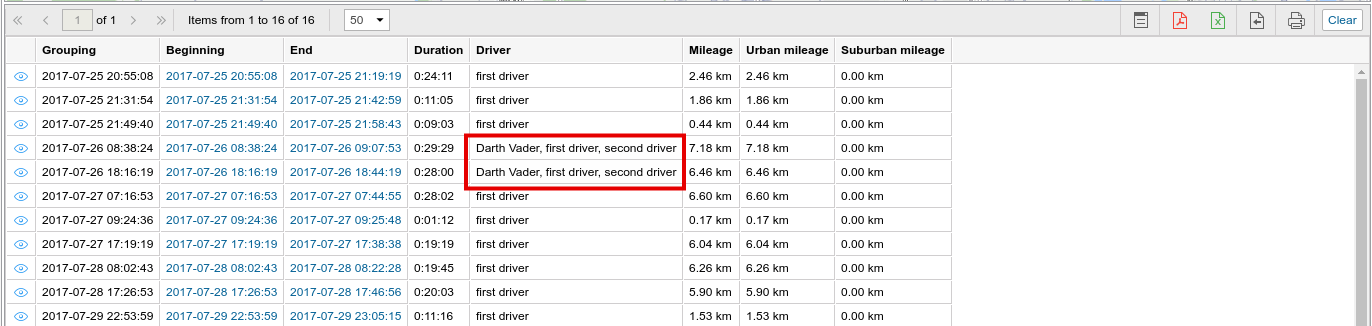

In the screenshot I have three drivers. They all were bound to the unit, and now I see them all in the report. It is a separate column. Drivers should have a unique name and should be easily identified by name.
What problem causes the absence of driver code in the reports? Maybe you can attach some screenshots?
