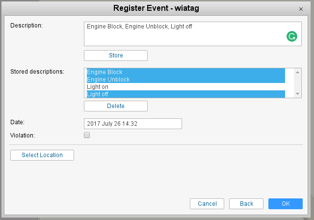

Hi, Tim.Mwandha!
I want to suggest you a variant of multiple selections. See on the screenshot.
And some explanations: you can select multiple variants with "Shift" or "Ctrl" buttons, they all divided by comma will get to "Description field" and will be displayed in a report as one event.
Will it save time for your customer?

Dear Tata,
Thanks for suggestion, however there are two issues with this approach.
1. Each event is a violation of truck road worthiness e.g. No side mirrors//No brake lights//Cracked windscreen. The client runs a report monthly to summarize all trucks with each violation. They analyze the kinds of violations against transport company/driver/vehicle make etc. This analysis would be difficult, if not impossible, if multiple violations were in the same line of the report.
2. The guys who inspect the trucks for road worthiness use tablets, and not PCs, as they are standing outside in the parking yard all day. When they 'touch' the stored descriptions, the violation list pops up as a check list which fills the whole window. It is not possible to select violation(s) while holding down the "Shift" or "Ctrl" buttons.

Re: Reporting Multiple Custom Events
Ok. Then I have plan B: to add button "Save and continue". They could add the events one by one, but the dialog will be opened all the time they need.
What do you think?
New interface of "Register Event" dialog is ready in Beta.
We got rid of one step in the dialog. Users are able to register several events from different categories without closing dialog.
In the case of Tim.Mwandha, inspector need to open once dialog and one by one choose worries and register them in units' history.
