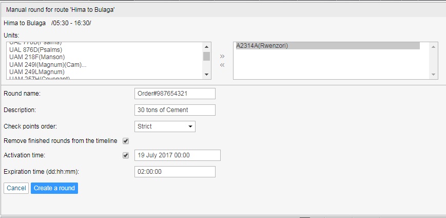

I have attached here an example of data which we would like to see in the print out.
I am taking into consideration that at the point of hitting the print button,
(a)this data has either been entered by the customer  i.e. round details
(b)already exists in the route i.e. geo fences/check points/ schedule ETA details
(c) already exists in the unit details e.g. unit profile.

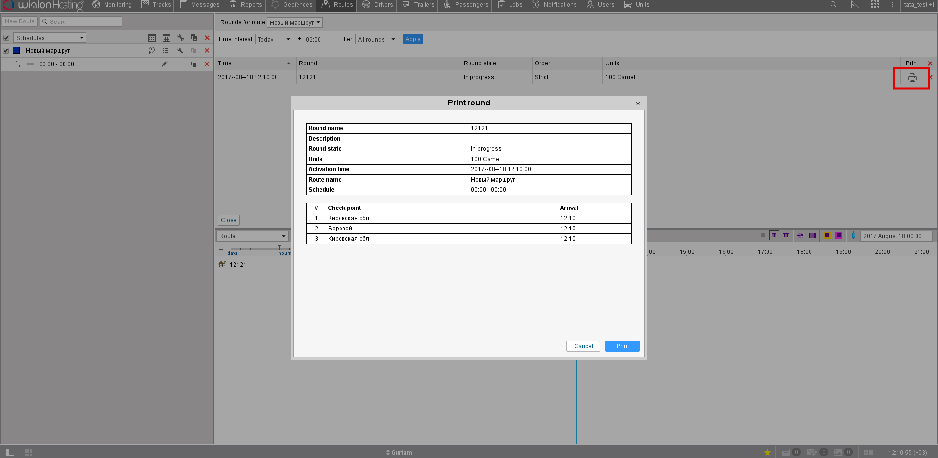

Tim.Mwandha, with unit profile info it becomes the other type of work. Can the info only about route solve your issue?
The list, that I suggest to be printed:
Round Name
Round Description
Date & Time of creating round
Activation time
Unit name
Route name
Schedule name
Schedule type
Check point names
Tatsiana Shmihelskaya

Re: Printing ETA of Check Points in Rounds
Tim.Mwandha, schedule printing option is ready! Try it in Beta.
