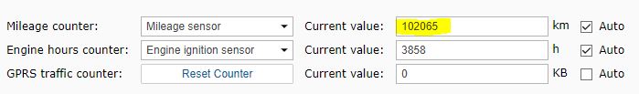

In other word, how do I get the number highlighted in YELLOW (see attached image)  to any of the field inside the SUMMARY report?
Regards

Initial/final counter is a value of counter sensor value, it's not mileage sensor , it's other sensor type
as there is not any created counter sensor for unit that is why you get zero in report
To get  mileage counter value you need to use table Statistics - Unit latest data
