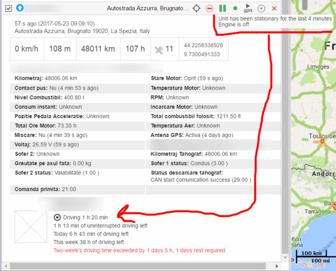

In my situation i am using bce tacho devices and driver activity is taken from the option "tachograph". But never, the information given in the "driver activity" window under the unit details is right. Especially when truck is with engine off and driver card taken out of the tachograph, many times the driver activity remaining "work" and driver id still showing.
You can see in the attached image, unit is stationary with engine off, min parking time is less than 4 minutes and it shows "Driving"
Anybody using this solution can recommend a workaround, for at least getting some exact data?
Thanks!

I think the Problem is with Device sending no more data.
YOu can see on your screenshot that last message 4:39 minutes ago and Wialon did not get new Info about tacho status.
We did not check it 100%, but comparing ddd files and status on driver status is mostly 30 min different.
But i will also check more detailed...
Wolf.

Hello busch.
The 4:39 minutes ago is the counter since movement or ignition changed their status.Device sent message and min parking time is 2 mins. Anyway, maybe you can check your devices config and share it with me. 30 mins seems very ok, in my case i have hours and thats what confuses customers smile
