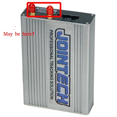

HERE IS: what is the terminal ID? is it IMEI?

b.chuka According to the protocol terminal ID = serial number.

is the serial code equal to IMEI? gp4000 don't have a serial code and only have a IMEI

b.chuka According to your example, 4291010001 can't be imei (because imei is 15-digit)
I wrote to our contact person of manufacturer. If I have any news I'll update you.

How can i know tracker's terminal ID? Where is the located in this ID? please ask these questions

I've already asked these questions.
